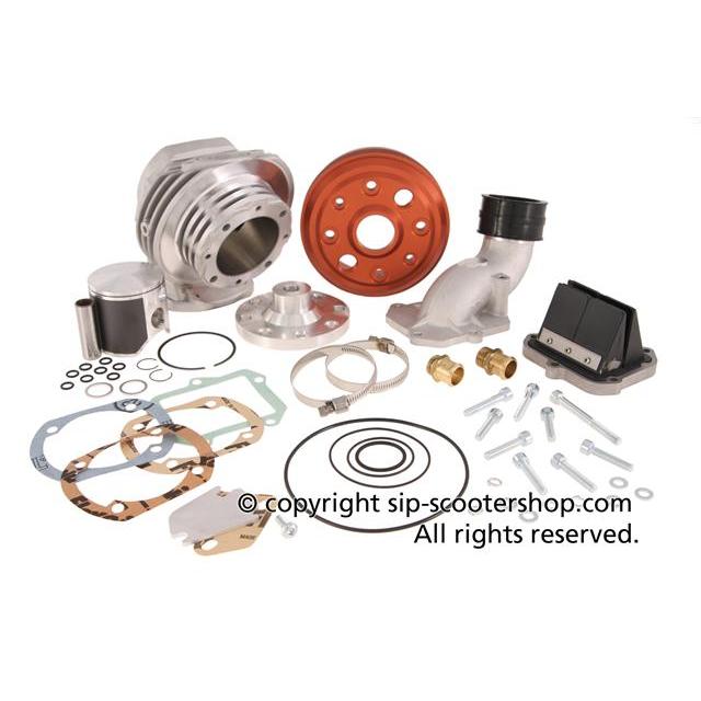

PARMAKIT
orce LC 144cc for Vespa 90-125/PV/ET3/PK/S/XL/2
aluminium, 5 ports,
stroke 51mm, Pleuel 105mm,
w cylinder head, Ø 60,0mm,
direct intake, incl. manifold,
spark plug centered
Aluminium/ 58/60 mm bore/ 5 transfers/ 135/144 cc's
http://www.sip-scootershop.com/en/produ ... f_75044600
e431db4d-3ebf-4052-b85f-78293dbadc57.jpg [ 41.21 KiB | 被瀏覽 17911 次 ]

這一套 是氣冷 還是水冷(我看的那是水導孔嗎) :hello:
